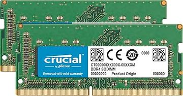

You could just run random video on YT "Mac Mini 2018 RAM upgrade" and check what they using. Just remember to buy 2666Mhz RAM. Here's the 2x32GB example link: https://www.crucial.com/memory/ddr4/ct2k32g4s266m/ct19038649

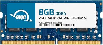

OWC Memory Upgrades For Mac mini (2018)
Upgrade the memory of the 2018 Mac mini up to 64GB through OWC, and save up to $800 vs upgrading through Apple. Includes step-by-step install videos.
