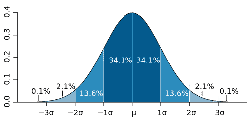

The “one-sigma” confidence limit is 68%. Therefore, if those data were really independently generated by a Poissonian process whose average behavior were described by the fit line, you would expect the data points to be equally distributed above and below the fit, with about 68% of the error bars crossing the fit line. The other third-ish will miss the fit line, just from ordinary noise. In this plot we have thirty points, and about ten of them have error bars that don’t cross the fit line: totally reasonable. On average one point in twenty should be, randomly, two or more error bars away from the prediction (or, “two sigma” corresponds to a 95% confidence limit).
