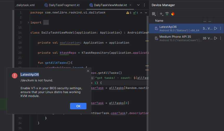

I found the answer. I had to run the following to unload the kvm_amd module.
sudo rmmod kvm_amd 2>/dev/null
I have no idea why this is true now, but once I ran that command then I was able to start the VirtualBox VM up with no problems.
QEMU
Well, maybe QEMU images run no matter what, because QEMU will still run even when the VirtualBox VM is running and with the kvm_amd module unloaded.
No idea why this module is running and interfering all of a sudden.
Docker
I could also still start my Docker (running MS SQL) without the kvm_amd module running.
Well, all my virtualization seems to be working now. If you run into this problem just unload your associated module
sudo rmmod kvm_intel 2>/dev/null
sudo rmmod kvm 2>/dev/null
Android Studio Device Emulator
I discovered, however, that for Android Studio device emulator (which I thought ran under QEMU) you will need the kvm loaded in again. (see error I saw when I tried to start the Android Emulator)
To load your KVM module again, you can just run:
sudo modprobe kvm_amd
When you return to Android Studio & try the emulator, it will now run.
I'll be writing scripts to quickly switch between the two.
