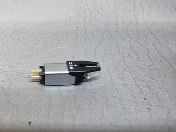

NOTE: The SP series (pictured below) were the only B&O® cartridges that replacement styli were available for. They are no longer available from B&O, but we can rebuild these for $150 with a Bonded Elliptical stylus, or for $250 with a Nude Elliptical stylus or higher end if desired.
